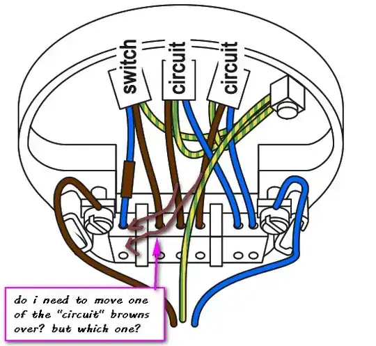

I've got the three separate ceiling lights all on the same switch. The other two are simple with a single grey cable fitting. But this one is obviously the key light because it has three main grey cables.
When I wire up this one up according to the diagrams available online I find I can't switch the lights off.

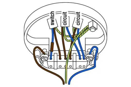

I've used this diagram as a guide, though there are many similar. It fits my setup/wiring/colours almost exactly (except in my case the original installer has taped one of my blue wires (which I understand to be my "switched live") red instead of brown as in the diagram. I presume that's an entirely cosmetic difference.
So, retracing my steps I detach all the light fitting paraphernalia and just try it with the three brown/live wires bound together (as should be standard according to the diagram) and still its sister lights (on the same switch) won't turn off. To kill the light I actually have to disentangle the three brown/live wires.
What am I doing wrong?

Per Tester's answer, and if the diagram is wrong do I need to move one of the browns over?

One of the brown wires will bring power to this point, another will go to the switch, and the final brown wire continues on to the next light. The markered blue wire brings power back from the switch, when the switch is in the ON position.
You need to connect the brown that has constant power, to the brown that goes to the switch. Next connect the markered blue to the light, and to the brown wire that leads to the other lights on the circuit.
The green/yellow, and blue wires in your image are connected properly.
As you currently have it wired, you have the wire that feeds the other lights connected to constant power. So they will always be on.

  1. Connect the brown hot wire to the brown switch wire.
  2. Connect the blue markered wire to the remaining brown wire, and to the light.
You're connecting it wrong
There are two ways to connect those UK 2-3-3 connection blocks with a switch. #1 controlling this lamp and also downstream lamps from this switch. #2 controlling this lamp only and feeding always-on power to other outlets downstream.
All your diagrams are for #2. You need to use the diagram for #1.
My answer here describes both cases. The neutrals stay put, you swap some other wires. I couldn't find a pretty diagram for your case, everyone who draws these diagrams seems to draw them for the other case.
If you don't know which is supply and which is downstream, take a guess - if it's wrong, this light will refuse to turn off.
