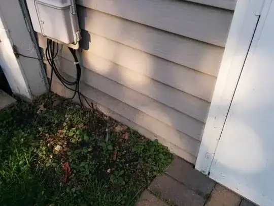

On the outside, the cable will go into the cable box which is conveniently located about 2 feet away.

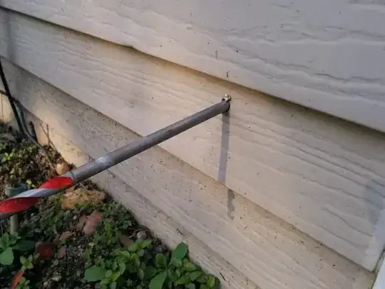

I picked a spot that was in between the door frame and opposite wall to start drilling, about a foot above the ground.
Comes out clean on the outside. You'll want to leave the bit sticking out so you can feed the coax back inside.

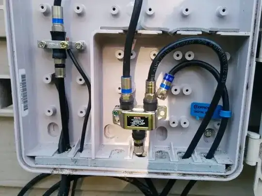

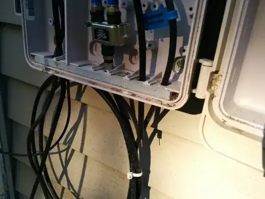

I fed through the exposed end of the coax from the inside of the cable box so that the end with a connector can be added to the splitter.
At this point, you may need to add the 3-way splitter if you don't want to replace an existing connection.

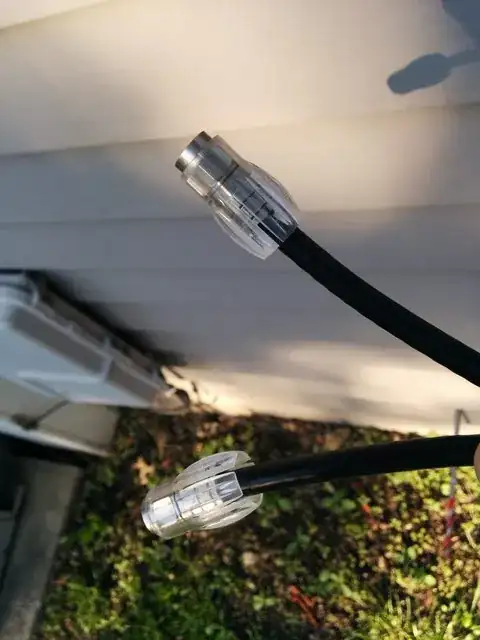

Before we feed the coax cable back inside, slide the plastic bushing onto the coax cable.
It's time to tape the cable to the bit to feed back inside.

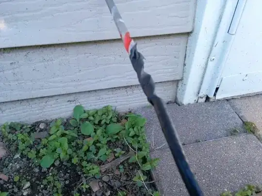

Using electrical tape, tape the coax cable to the bit.
Pull the drill bit back thus pulling the cable through the wall.

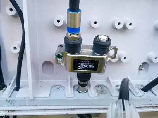

That is why on the outside the USE those grey cable boxes, it allows protection of the cable coming up straight from the ground near the house, inside of it using an L connection for the bend, or just room to curve, and then enter the house. Any feed with out protection that doesn't come straight out near the house will get damaged eventually if not immediately. Always seal well, near the coax and on the outside lip of the brushing if doing it this way, or any possible crack behind the cable box and inside. Reason? Ants (and pests), air and water (weather). On the inside of the coax you can caulk it also, for same reasons, before putting on plate. Just make sure it's a thin layer not to push out the plate.
The service provider has installed a 1-way TAP which insures the modem has a very clean signal from the "OUT" terminal, while TV's are fed from the "TAP" terminal have normal attenuated signals.
While everything described in the OP's preparation and step-by-step list is good, this minor overlook can be critical to the overall system.
To remedy this, the OP would purchase a two-way splitter and connect it to the TAP terminal output. Then the existing TV coax and the new coax would connect to the splitters two outputs.
