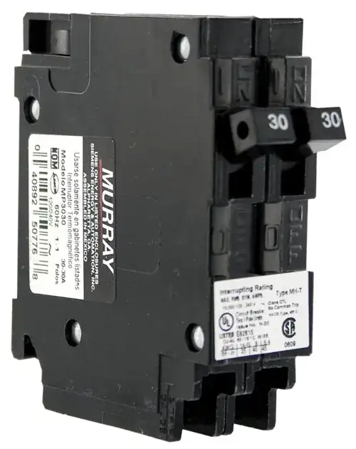

Specifically, there are two Murray MH-T 30-amp breakers. These are tandem breakers and not "slimline" or "thin" breakers -- the two breaker switches on each are not connected in any way. One of these breakers is used for the clothes dryer and the other for an electric water heater.

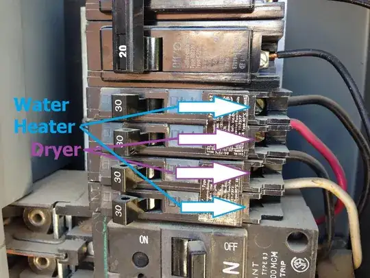

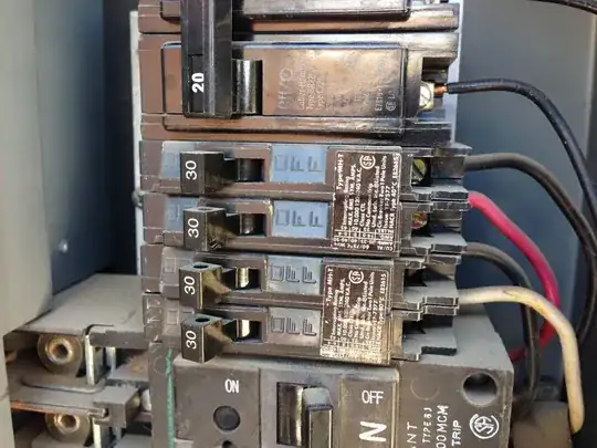

EDIT: Added photo of the breakers in question: suspect breakers
The very top is a double-pole 20-amp breaker that's fine. The first 30-amp tandem is the dryer breaker and the second is the water heater.

    If I understand your description correctly, the only flaw here is the handles of each leg need to be tied together so that if one leg trips, the other side is shut off as well. I would like to see a picture of the installation before making a final determination. – bcworkz May 26 '14 at 02:21
  • Added photo of the breakers. The top tandem breaker has its neutral attached to the neutral bar, but I can't show that since that space is an unholy mess. – Kurt Granroth May 26 '14 at 05:00

It sounds like you may be mistaken as to how this is wired, or that perhaps I'm just not understanding your explanation. As others have mentioned, it's not possible to get 240 volts from a single pole in a 120/240V split phase system. Each tandem breaker provides 2 120 V circuits, this is true. However, if you measure between the terminals on a single tandem breaker, you'll get 0 volts. This is because the terminals are both powered from the same leg, and so are at the same voltage potential. If you measure from a terminal on the top tandem breaker to a terminal on the bottom one, then you'll measure 240 volts. This is because each breaker is connected to a different leg, which are each one half of a 240 volt circuit.
With all that said. For this setup to work, one appliance would have to be connected to both breaker. Something like this...
Labeled Breakers
Notice that each appliance circuit has one wire connected to each of the tandem breakers. In this situation, you'd need a device like Speedy Petey shows.
common trip device
Which ties the breaker handles together, to provide common trip characteristics.
Notice how the inner handles are tied together, and that the outer handles are also tied to each other. This way if either trip (or are turned off by the user), the entire circuit is shut off.
If this is wired the way you've explained, where the dryer is connected to the top tandem and the heater is connected to the bottom. Then there's some magic going on in those breakers.
    You are absolutely right! The dryer takes the top-most and bottom-most switches with the water heater taking the middle two. That's absolutely good to know because I'm going to be replacing those with two full double-pole breakers and it looks like I would have wired them incorrectly (at least at first)! It finally makes sense why this works in the first place. Thanks! – Kurt Granroth May 28 '14 at 01:52

Murray MH-T MP3030 (this unit gets its power from one leg to produce two 120V circuits)
The setup is working because each breaker pair feeds off the proper panel bus leg (One attaches to L1, the other to L2). From your added information, each 240V circuit is split across the two breakers to do this.
What's Wrong -- The major safety concern here is that with a circuit fault, only one of the breakers in the set may trip, leaving the 240V circuit partially energized. For instance if the dryer heating coil burns through and one end touches ground, that side will trip, leaving the other leg hot. You definitely want a circuit fault to totally power down both legs.
Also related is the fact that anyone not paying attention to the panel setup may power off the circuit to work on it and not realize they switched off adjacent pairs instead of alternate pairs of each 240V circuit, leaving a hot leg in the circuit they think is powered down. You want things to be fail-safe. This isn't fail-safe, but is a booby trap waiting for the inattentive or hurried. NEC frowns heavily on things like this.
Murray bus backplane with interleaved fingers so adjacent full size breakers are on opposite legs. Not true for the MH-T MP3030 breaker pair, each breaker in the set is half-width and the combination is fed off only one leg blade.
