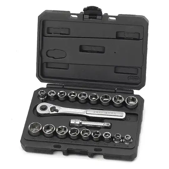

  3. A ratchet and socket set like this will last decades. 3/8 inch drive is a good compromise between cost and durability/strength. I still frequently use my Sears Craftsman hand tools accumulated in the 1970s and 1980s. The few failures I have had were cheerfully replaced (for free) years after I bought them.
For a nut so far down the shaft as that, a deep socket is called for. Those can be purchased individually at larger stores. Or sets of deep sockets at most stores, though that might be spending a lot of money for items you may never use. enter image description here

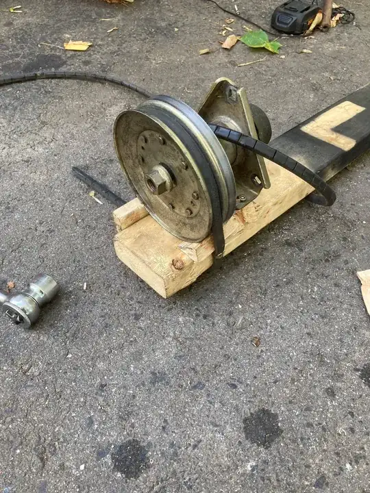

Screw an old v belt around the pully to a 2X4 or chunk of wood as tight as you can; I put wooden shims and screwed them into the inside diameter, and the belt to the shims to make it super tight so the pully wouldn't move. Then just attach the wrench and whack it as hard as you can with a mallet to knock it loose. It worked for me when nothing else would.enter image description here
