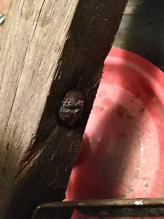

The hack saw thing didn’t work. Locking pliers did. This was the slot I cut, but I just couldn’t find a screw driver that would hold it firmly enough. I also tried drilling - no luck. And regular pliers. That’s what probably really damaged the end of the bolt as the bolt would just spin in them. enter image description here
