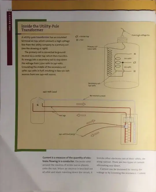

I had this exact same question. It took a professional electrical wiring book to explain it to me. It is really complicated, so I will have to start by explain how the electricity gets to your house.
The piece of equipment that is responsible for the electricity getting into your house is the Utility-Pole transformer.... and I am realizing this is waaaaayyyyyy to complicated to explain without a picture, so here is the page from Rex Cauldwell's Wiring a House, 4th edition:
Page 1
Page 2
Let's brake this down: Basically, the two outside connectors are 120V power taps that when connected together, you get 240V. But when either one of them is connected to the Centeral Tap, you only get 120V. Again, this is really complicated, and you should really ask a qualified electrician for any detailed explanations, not a 16 year old child who was barely able to wrap his head around this. And don't you dare start talking about different power phases...
