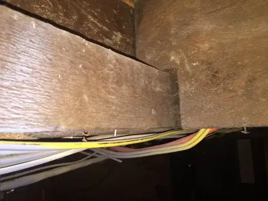

joist/ledger connection
you can sort of see the separation here
simpler case against interior beam -- hard to move wires

  • Very sorry I disappeared after this; that darned life keeps intervening. Anyway, the issue is that there's a joist and it connects to a supporting member (this is a problem both at a sill and at a beam, actually) where there's a ledger. I want to leave the ledger where it is, but take the load off the ledger/rabbet and move it properly onto the whole members. This can't be a completely unusual retofit problem, since I've had more than one house where rabbet/ledger issues show up. I'll add some photos. The photoing, however, has also led me to see some separation :( – Andrew Sullivan Sep 06 '15 at 01:54

  • This is hugely helpful; thanks. But the only way I can see these could work is if I cut the existing ledger out or else bought the really short ones to do the ends only. I guess what I was hoping for at worst was one that did (say) L30 on one side and L50 on the other. That'd give the cutout over the ledger and at least would give end attachment better than what's there. Modifying doesn't seem engineering-sound. I like the flat plates, though, and may use those. Thanks so much. – Andrew Sullivan Sep 06 '15 at 02:04
Like you mentioned, I've seen it where they put blocking in between the joists on the ledger board. The 2x2" ledger board fits a 2xN sized lumber, so toe & face nail blocking to build up the rim joist to the edge of the ledger board, then you can get a normal single/double/triple joist hanger. Just be sure that the blocking is snug and securely fastened to the rim joist (girder) so that it can hold that joist hanger.
