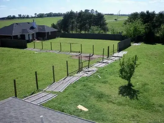

Edit: Here's some pictures of the fence line:

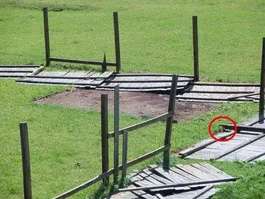

And here's where the fence post is snapped:
That big spot without any grass is where my neighbor's shed used to be before the tornado carried it off.
