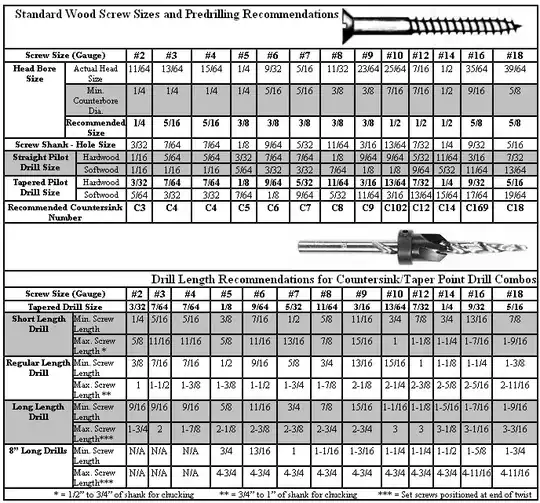

    I usually prefer a torx (aka star) head to square. However, for fancy work, setting a Robertson screw so the square is angled just right makes it look like diamonds. – Jay Bazuzi Jul 09 '11 at 02:38
If you're having trouble with just a few screws on something you want to look nice, you can always drill a pilot hole. This way you're just fighting the torque on the threads, rather than the torque required to displace wood around the shank and drive the threads.
Source

  • Useful diagram - I'll just have to convert to metric. – rbrayb Jul 08 '11 at 00:52
  • @nzpcmad: You can probably search for something like "metric pilot hole chart" and find one for metric screw sizes rather than converting the whole thing. – Doresoom Jul 08 '11 at 13:38
    Note that there are two kinds of screws, and hence two kinds of drill bits used for predrilling. Traditional screws taper evenly toward the tip, and should use a taper-point bit for their pilot holes, as shown. Modern screws (also as shown above) have a constant "root diameter" until you get to the tip; pilot drills for those can be straight bits of that diameter or a bit smaller. (If you _really_ want to do it right, you then drill a slightly larger section of pilot hole for the unthreaded portion of the shaft and, of course, countersink for the head.) – keshlam Jan 05 '15 at 23:10
