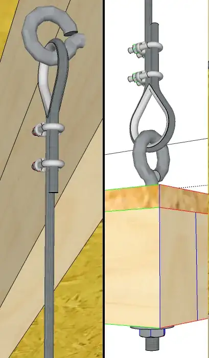

Did with a eyebolt above and metal plate below for load distribution. No visible sag at any point of the shelf.
View from below Side view Eyenut of this sickness is probably an overkill given the load, but it's smallest available.
