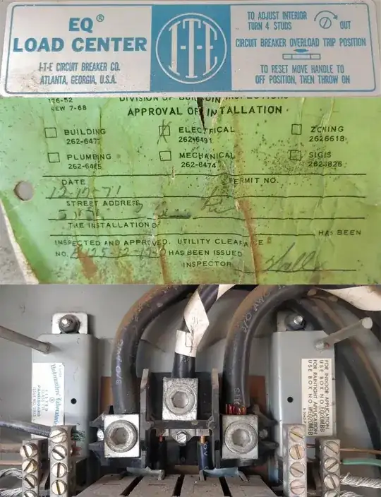

  • What type of breaker panel is this? It matters for the breakering for these MWBCs. – Harper - Reinstate Monica Jul 16 '19 at 15:26
  • Can you post photos of the *labeling* on the inside of the breaker panel's door? – ThreePhaseEel Jul 16 '19 at 22:19

  • @Enkode -- there should be a label on the hinged thing (i.e. the door you normally swing open to get at the breaker handles) that's attached to the deadfront (i.e. the cover you took off to gain access to the wiring inside the panel). Can you get us a photo of that label, or has it gone AWOL? – ThreePhaseEel Jul 17 '19 at 22:44
  • I attached every label since you did not really specify what exact label you are looking for. – Enkode Jul 18 '19 at 05:20

Your panel is a Siemens EQ, which requires Siemens breakers. However, the two GFCIs (spaces 4 and 19) are GE THQLs, some of the other branch breakers (1/2, 11/12, and 17) are Eaton BRs, and the tandem breaker in space 20 is a Square-D Homeline, none of which are listed for use in a Siemens panel. Replacing these alien breakers with the correct Siemens breakers (or UL classified Eaton CL breakers) will be needed to get this panel to meet Code.
