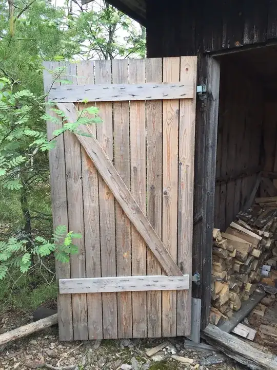

wood shed door with diagonal
I think the question of a diagonal is imperative, as is already pointed out in the earlier answers, that I decided to add an image of a wood shed built in the 1950s with a door that still doesn't sag, even after decades of beating from the elements (the hinges have been renewed, though).
It is clear that there are cracks between the individual planks which is the leeway you will need to have for the wood to shrink'n'expand.
In the image you can also see how 4" nails have been used to fasten the planks to one another by turning the nail inward before hitting it home. This technique, in Finnish is called "kotkaaminen", in English it's called clenching, and is a really fool proof method of making an inexpensive and long lasting fastening. The nail hooks into the wood on the back. Using nails gives your wood the clearance to move through the seasonal changes in humidity.
