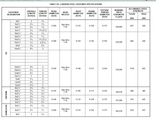

There are various reports and documents available online that should cover this. See the ICC-ES ESR-3201 report from this year on GRK screws or the same document, but embedded in ICC-ES's website.
The tables from the ICC-ES documents are too large and comprehensive for me to transcribe here, but as official documents from code governance bodies, those links should be reliable... here is a screenshot of one of the first tables, which includes shear strength for various screws, including the R4 model you mention in your question:
Carbon Steel Fastener Specifications table from ICC-ES' 2021 ESR-3201 report
And from GRK's own webpage on compliance:
Having an ICC-ES ESR report means fasteners have ICC approval. GRK fasteners are ICC code approved for exterior use in ACQ pressure treated lumber and have the strength to meet all your general construction needs. A building inspector will be able to use an ESR report to code approve your construction projects.
  • ESR 3201: R4 multipurpose screw, FIN/Trim screw and Kameleon screw are code approved for the IBC and IRC for structural strength and corrosion resistance. They are the most popular screws for installing decks.
Given that the shear strength of a 16d common nail is 120 to 150 lbf (depending on the material it is nailed into), it looks like GRK's R4 screws—in any length—are roughly 3x as strong in terms of shear strength, assuming I'm interpreting the table correctly.
