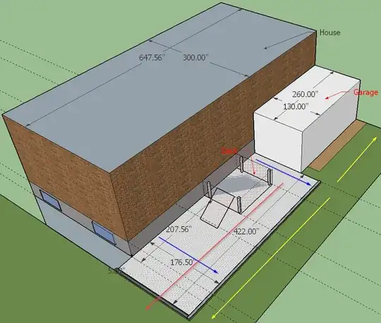

This is about a cement pavers patio.
On the figure below the yellow arrows show how the lot is graded
For grading the patio I seem to have two options:
-along the blue lines
-along the red line
Which gading direction is recommended? Bigger picture here: https://i.stack.imgur.com/GSmHh.png
MiniMe
  • 3,400
  • 80
  • 134
Blue, or blueish-purple (ie, at a slight angle so it's away from both the house and garage, but closer to blue.) You want to get the water away from the building, not funnel it alongside the building.
Responding to comment: developing a grade is a "simple-yet-tedious" process, for the most part. My preferred method is to set some stakes 3-4 feet tall, mark them all with a level (laser these days, dumpy or transit or water or... in the past), and then mark a line on each, depending where it is, at some fixed distance above the desired grade - say 30" above. Then I run strings, tightly, between those marks, and mark my rake and/or tamper handle at 30" - it's then a simple matter to line up the strings (to form a plane floating 30" above grade) and see if the rake or tamper is too high (mark above) too low (mark below) or right on (mark even with) when set on the surface at any given spot. For convenience the plane should not be too low (or it's a lot of bending to see if things line up) nor too high (it's difficult to get stakes well-anchored for a taught string when the string is 5 feet up the stake.)
You could set something to screed on by adapting the same method - I don't recommend screeding for a sand base - it needs to be well compacted, or it will shift, so screeding it doesn't really do anything much to develop the base you need, IME.
In either case "sloping two ways" is a simple operation of referencing an imaginary LEVEL plane & subtracting for the position in both X and Y before making the mark on the post or setting the plank, pipe, or whatever you'd be using to guide your screed on the non-level plane you are creating.
For a concrete example, suppose we slope 1/8" per foot in blue and 1/32" per foot on red. The high corner is where the garage and house meet. The outside corner by the garage is dropped 1.83 inches. The house side of the end away from the garage is dropped 1.09 inches, and the outside corner at that end is dropped 1.09 + 1.83 inches. Any spot in the middle can have a precise elevation computed, and then you do your best to approximate that in practice, and don't sweat 0.05" too much. For the sake of simplicity and sanity in measuring you can set your grade stakes on an 8 foot grid, for instance, rather than "right at the edge of the patio" and you can actually set a row beyond that if it makes it easier to "see the plane" while working.
  • Would you give it any slope along the red line? I am not sure how one can screed to 1" of sand or anything else when you need to slope on two directions – MiniMe Nov 12 '14 at 01:16
  • I was trying to formulate an answer to help describe what you meant. The edit added what I would of; [screed guides](http://concrete.com/leveling-concrete-over-an-area-wider-than-your-screed-board) ; use a grid system, it's hard to float 14'x40'. – Mazura Nov 12 '14 at 03:43
  • Thanks guys. I still have these questions: -Why do you have to still grade along the yellow lines if you already graded along the blue lines? -How do you screed the sub-base layer (the gravel) to follow the contour lines defined by your grid? If you need to compact that layer with a compactor (not a tamp) then you can not follow the grid. – MiniMe Nov 12 '14 at 12:24
  • There's no problem at all with following the grid. Compact, look for high and low spots, move material, recompact, rinse, lather, repeat. Rather than wasting time with screeds (they work for concrete - dirt, not so much) just go around and dig down or pile up to get spots you can reference as you work in-between them. Reference those spots to the string plane. As you get closer, more spots. Dust with chalk or lime if you have trouble picking those spots out. If you set lines 30" above the sand surface and want an inch of sand, put a line at 31" on the tool handles for the gravel surface. – Ecnerwal Nov 12 '14 at 15:11
    In doing pavers everyday during the summers for 5+ years for a landscape we never screeded the sub-base, not saying you can't just saying we didn't. We used large landscape rakes to get it nice and "eye-leveled" and then compacted from there, if needed we would rake down the high spots and fill in any low spots, this was rarely needed. We then screeded the sand base with the slope. If I were dealing with the area above I would definitely screed out from the House as my main grade (Blue). Then it depends on how you plan to finish the outer edge. If you want to match the slope of the ground... – BD72 Nov 12 '14 at 17:52
    ... I would lay out my screeds in a fan-like fashion. Something like the purple lines I added here: https://drive.google.com/file/d/0B41uyJ7YDO0eRlJqZFZPWWloM0E/view?usp=sharing That would allow me to check my slope in both directions. – BD72 Nov 12 '14 at 18:03
  • @BD72: I don't think that you can screed properly that way because there is no guarantee that you can identify those lines ..to identify those lines is a complex geometry problem, I don't think you can eye that – MiniMe Nov 13 '14 at 12:24
    Actually you can, I have done it. I can eye ball it, you may need to pull grade lines and use grade pins to set your grade. The green lines in this image should give you an idea of how to establish your grade. https://drive.google.com/file/d/0B41uyJ7YDO0eckVpaHhJYjQ2b3c/view?usp=sharing As a suggestion this may be something you want to hire out if you feel overwhelmed. There are professionals for a reason. – BD72 Nov 13 '14 at 16:16
