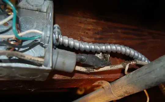

The True Knob & Tube Danger: Modern Rework
The danger with K&T is that somebody messed with it. Here's a picture of a pretty typical example. Someone jacked a new circuit in. They cut the old knob & tube short, destroyed the original insulation, did a hack tape job, then installed a modern metallic cable almost touching that mess. This particular instance created a big spark some years later as the grounded metal cable hit the now bare wire. Original K&T installers never let the wires touch except protected by ceramic tubes.

    Yikes! That is a scary splice! I became frightfully aware of the hazards of K&T wiring when I was mopping the floor in a closet. Most of my wiring runs were replaced with Romex, but not all. I got a little water on a pair of wires and heard a diabolical sizzling. I shut off the circuit and replaced the wires with Romex as soon as the floor was dry. No more K&T for me. – Suncat2000 May 09 '19 at 12:34

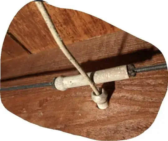

A big problem with K&T is the horizontal runs - sagging over time means stress on the insulation, which becomes brittle from oxidation (not the wire - the rubber insulation), and can break off. You then have (a) bare wire(s). Should those wires come in contact with horizontal piping - particularly after something like a renovation, which usually redistributes loads and causes fresh settling - you have a recipe for a short and a fire. This exact thing happened to a balloon framed Victorian (vint. 1898) in RI, causing a fire on the third floor. Fortunately, the smoke was spotted by a passerby who came in, woke the occupants, and saved their lives. The water damage was extensive, and the cost to restore with matching full dimension lumber, lath/horsehair/grey coat and finish plaster was very high. A beautiful Italianate Victorian was nearly lost to history but for the passerby. All K&T was replaced, and worth doing.
Note that a proper K&T installation added tubes at the point of crossing a pipe or another wire. Probably the pipe was added later in the fire above:
Knob and Tube wiring proper crossing detail extra tube
